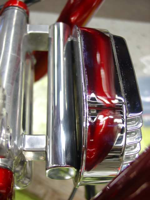

When the bike came in looking like the picture in the previous post, it had a custom regulator mount (see first picture).
This is where the regulator mounts. The bracket was made to center the regulator between the frame rails.
So I measured everything up and drew diagram with dimensions for the machinist. I picked a larger piece of aluminum to make it out of, 1" round stock. This allowed me to counter sink the bolt heads so they don't interfere with regulator. Spacers were required with the initial bracket supplied. And the polished rounded bracket matched the front of the engine better.
The part was made to spec.
]I polished the bracket and it fit perfectly.
Then I mounted the regulator and it fit without any problems. It seemed to be centered between the frame tubes very nicely.
Back side view.
Overall look on the bike.
